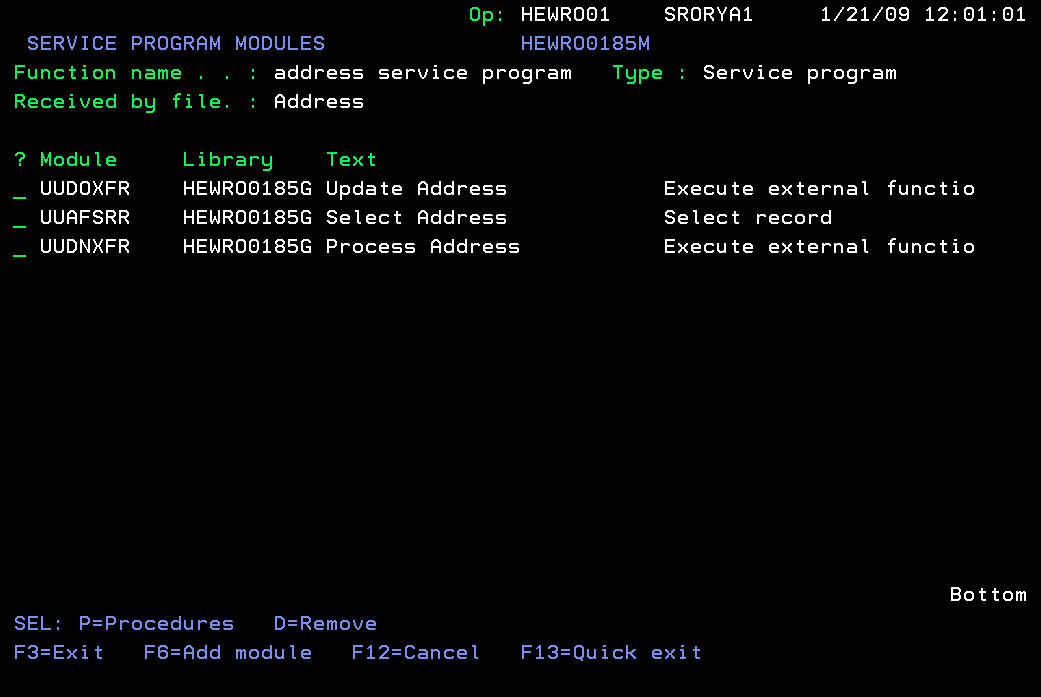

The Service Program Modules panel is called when option M is taken from the EDIT FUNCTION DETAILS panel (above).
Adding Modules and Procedures
From this screen, you can see which modules are currently bound into the Service Program. This list may include both 2E modules and external (non-2E) modules.

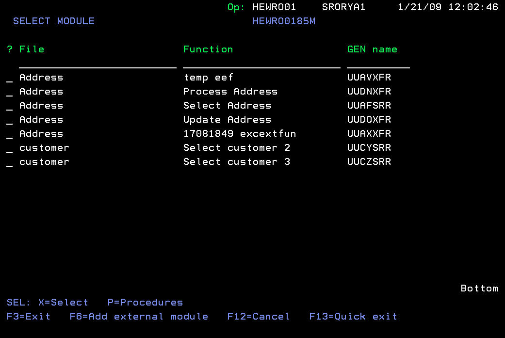

You can also press F6 to go to the SELECT MODULE screen
Select Module
Adding Modules and Procedures (2)
You can select one or more modules to bind into the Service Program, by using subfile option X (displayed) or 1 (not displayed, but active anyway). This automatically makes all the procedures from the module exported from the Service Program. Alternatively, you can take option P against a module and select which procedures they would like to export from the Service Program.

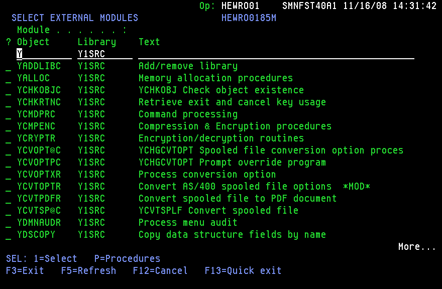

You can also press F6 to display the SELECT EXTERNAL MODULE screen
Select External Module
Adding Modules and Procedures (3)
You can select one or more external (non-2E) modules to bind into the Service Program. The initial screen is displayed empty, and you can specify subfile control criteria so sub-select the modules to display. As with the SELECT MODULE screen, option P is available to sub-select procedures from within the module to export from the Service Program.

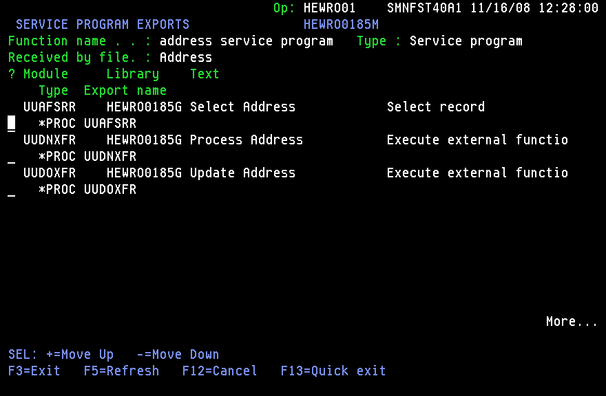

Service Program Exports
The Service Program Exports panel is displayed when option P is taken from the EDIT FUNCTION DETAILS panel:
Adding Modules and Procedures (4)
This allows you to display the list of procedures which are exported from the *SRVPGM object, and if necessary, re-order them.
Note: Although this is only a requirement where, due to modules being removed and added, the list may have changed-typically, once a Service Program has been generated and compiled into a *SRVPGM object, this list would never be changed).
